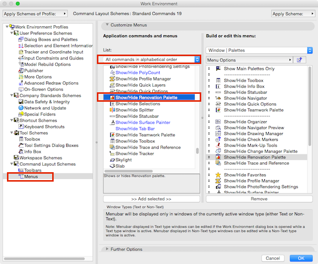

The palette is possibly the easiest way to set your defaults. You may also open the Default settings of your tools and set the Renovation Status under the Tags and Categories panel.
Under normal cisrumstances you can make the Renovation palette visible by going Window > Palettes > Renovation. But since you do not see it:
A. In the Work Environment dialog:
- Click Menus on the left
- Choose to List: All command in alphabetical order
- Scroll to Show/Hide Renovation Palette
- Drag it to the Menu you wish to have it in on the right.
OR, if that is not working for you:
B. I suggest that you and then apply the Standard Profile 19. From there you may edit the Profile to use your custom Shortcut scheme and Workspace scheme. But if you go so far as to edit your Menus you should re-add the items you prefer manually.
I hope this helps.

"Under normal cisrumstances you can make the Renovation palette visible by going Window > Palettes > Renovation. But since you do not see it:
- Drag it to the Menu you wish to have it in on the right. "
This worked! Thank you very much!

I cannot get my renovation palette to display and to complicate matters following the above instructions I have discovered that "all commands in alphabetical order" displays o9ll option greyed out.

David:
The commands are greyed out until you select and enter one of the Menu headings on the right side of the dialog box. A command cannot be added to the menu bar itself, it needs to go into a menu or submenu.
