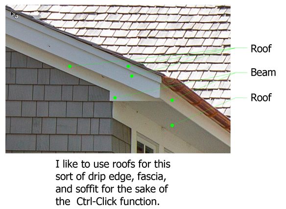

I consider all ArchiCAD library parts as place-holder objects since *not one of them is geometrically correct enough for detials.*   Try to make yourself a Complex Profile Gutter with smooth curves like a traditional K-Style gutter or something.   It will not be anywhere near close to smooth without a lot of fuss, and if you do make one with a fill that is very-very segmented, it will probably slow you way down if you have a lot of it in your model.   Since you may need smooth curves anyway for Rendering and/or Presentation Views, Details... you will probably only want to use the very high polycount objects temporarily and only where and when they are necessary.  For most situations you don't need the objects that will give you the best graphics possible.

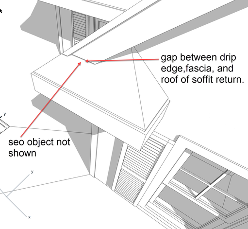

  This is especially true when your have and intersect between (for example) the fascia and drip edge with the roof of a soffit return.  I reality, you will what to use a 1/2" thick SEO roof to trim fascia and drip edge to so they will not actually come in contact with the roofing.  There should be an air gap there.

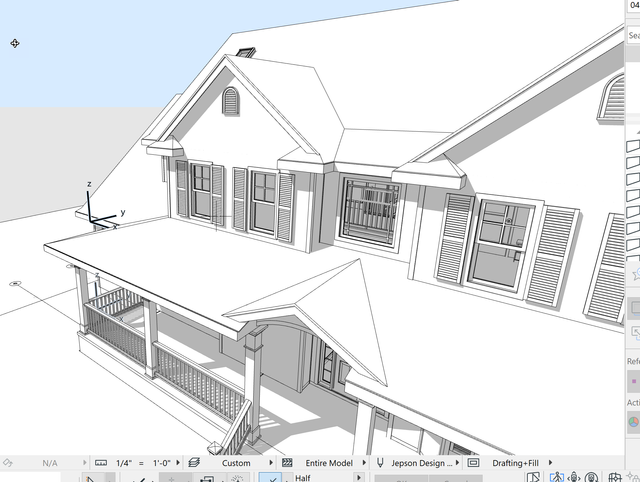

The other reason to use roofs for some of these objects is that you might very well be changing the roof pitch and when you do, the Ctrl-Click function will make that easier for modifying soffit returns and some things like that.   I use the same pre-molded assembly of drip edge, fascia, soffit...from one project to another - I just tweak it for the new condition.   No need to model things over and over for no good reason.
This is just one way of doing it -  I might use several different ways on the same project, for different reasons.  Nothing wrong with using beams, slabs, walls either.
But I think you will find that modeling with pre-modeled assemblies that you just tweak for each project will be much faster than modeling everything from scratch - every time.
Also keep in mind that you only need to model one side of a pitched roof - mirror a copy about the ridge. move copies of one gable end to another... that sort of thing.
