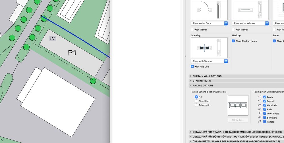

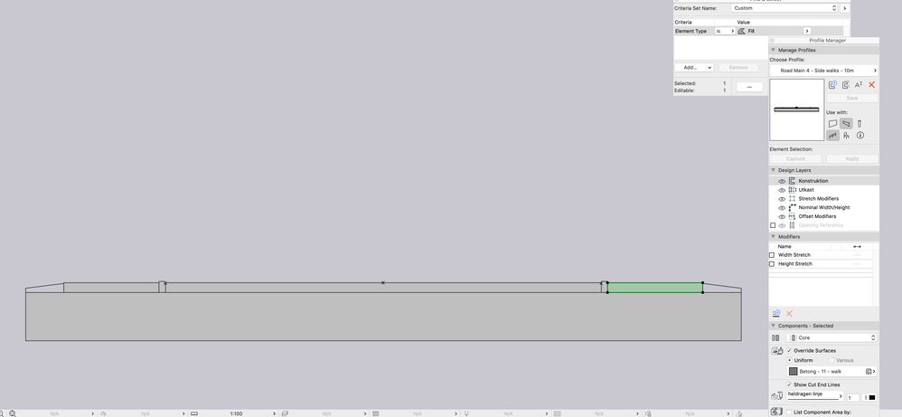

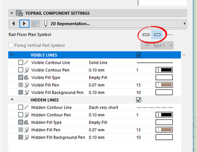

Hi, rI did roads design trought railing manager and profile manager.
Honestly I don't know any other better way to do it.
I wonder if I can show it also in 2D, now I only see the railing line, but not what it looks like ( foot print/top view ).
It's a bit tedious to make railings / roads and then make fills for 2D

I just quickly made a similar profile and used it in the top rail of a railing.
It shows on plan just fine.

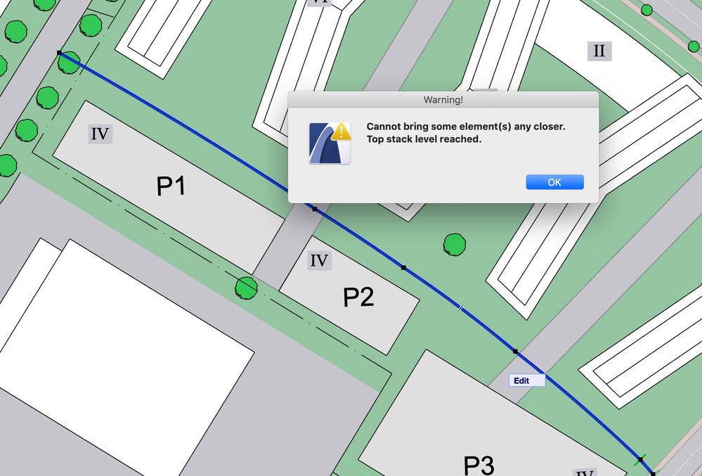

What happens if you place a railing off to the side of your model where there is nothing else around?
The only other thing I can think of is if the railing is set to show on the current storey.
i.e. make sure if you are placing it in storey 1, it is not set to only show in storey 2 - or something like that.

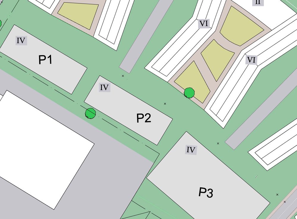

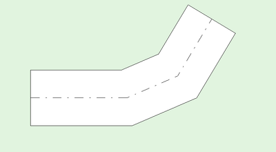

I have problem to be able edit this post - here is example how I made fill and if I delete this fill there is railing what is roads. I would like to get railing tool with visible footprint/2D fills
I hope you understand me 🙂

I’ve used the railing tool like this but you have to make junctions in other ways.
I have just used the mesh tool for the road surface then added kerbs using the railing or even the beam tool

I have and still nothing showing to me 😕Skärmavbild 2021-12-15 kl. 16.33.35.jpgSkärmavbild 2021-12-15 kl. 16.33.48.jpg

In the 2D representation for the toprail, do you have the with or without axis option active?
Rather than axis only?

Is your railing a single complex profile? Or are the road, verge and foot path separate rails with their own profiles assigned?

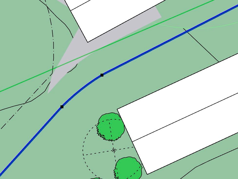

I have .. unfortunately I can't see even blue line 😕

I did like one complex profile.
