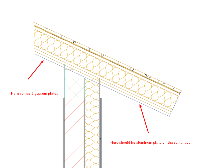

Hello everyone,
i cant find any article about situation im in. The thing is my roof needs to have different layers inside and out. For example, inside on the last layer there should come 2 gypsum plaster boards, but outside on the last layer it should be an aluminium plate. I was searching for Profile Manager solution but it doesnt work on roofs. Do you have any particular solution for this kinda problem where i can modify the layers of the roof or in worst case scenarion i have to turn roof into morph in order to do that kinda thing? Im just looking for the best solution. Thanks!

I am familiar with composites, but the thing is as i said, i need to have one layer outside, and another one inside but on the same level.

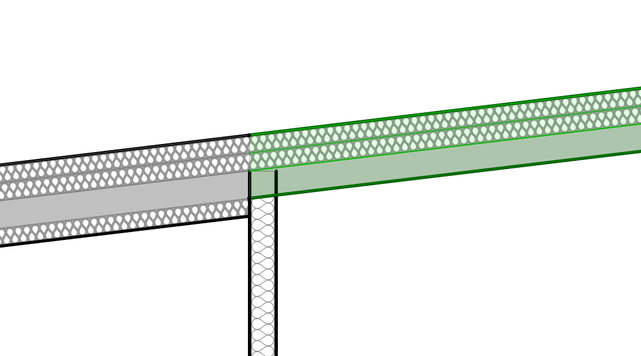

You didn't specify what inside/outside actually meant.
For your situation I'd split the roof into two distinct parts (in/out). And edit the composites accordingly.
4 weeks ago
In that instance, I usually model that underside finish as 2 separate elements (Interior Ceiling and exterior Soffit), and have them on a Ceiling layer, so it appears on our Reflected Ceiling Plan.
It is an imperfect workaround, as any adjustments have to be made for multiple elements.
3 weeks ago - last edited 3 weeks ago
I would do this too.
Model the main roof (the top structure) that is common to the entire roof.
Then model the underside ceilings as separate roofs (because they are).
3 weeks ago
And if your client decideds they want a flat ceiling instead, you do not need to change the constuction!
