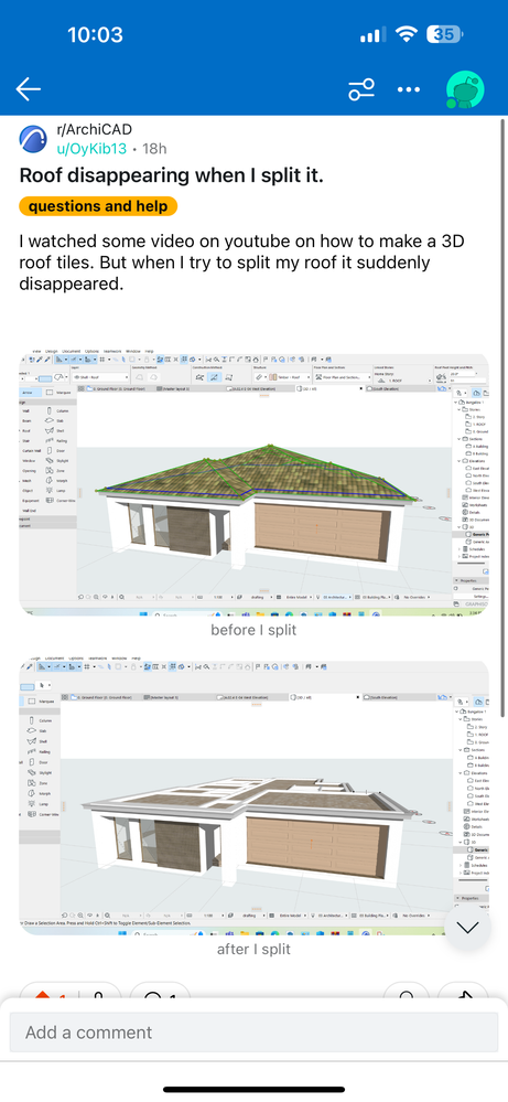

I watched some videos on YouTube on how to make 3D roof tiles. But when I tried to split my roof, it suddenly disappeared.

The roof sir. I am trying to apply the accessories but first I need to split the roof. But when I split it, it suddenly disappeared instead of separating the roof planes.
So, you have a multi-plane roof and you right click and choose 'split into single roof planes' ?
If that is the case, I have not known roofs to disappear.
Can you show a screen shot of the roof while selected before the split.
Here it is sir Barry,  

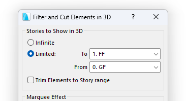

Very strange.
The roof appears to be in its own storey, but that should not matter.
I can't see anything else unusual.
The roof is grouped with something, but again that should not matter.
