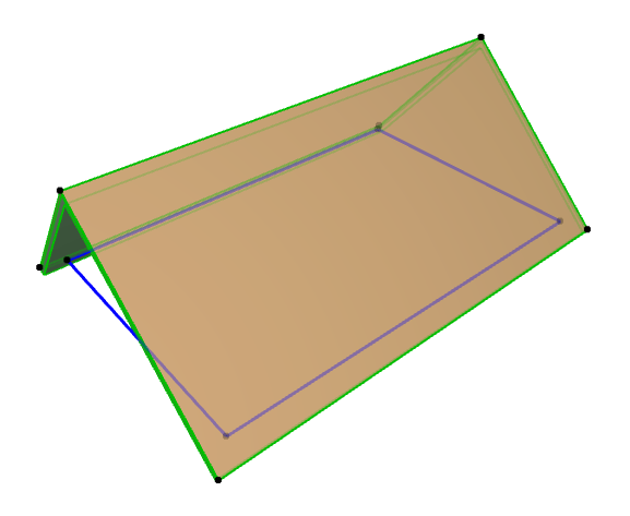

Hello I'm getting crazy on an issue
I can't connect 2 single pan roofs.By connecting I mean I would like those 2 pan to act together like a multiplan roof (that would let me crop wall by those 2 pan at a same time)

arthuragone,
After you did that, select both Roofs, click the common edge (the ridge) and use the Custom Edge Settings button of the Pet Palette. Then use the Set Mitred Edge button.
Then they should be able to Crop Walls properly.
Alternately, you could very easily create this using a multi-plane Roof. Draw a rectangle shaped multi-plane Roof, which will have 4 planes. Then set the two opposite planes to Gable, then set the slopes of the other remaining two planes to the desired angle values.

arthuragone wrote:
Regarding your Alternate method, It work pretty well, but in this case, I can't find how to have one edge at an altitude (let say 5,00m) and the other edge at another height (let say 3 meters) ?
In case of multi-plane Roofs, the Pivot line (the blue line in the attached image) must always be at the same height for all Roof plane.

Two methods:
1. In 2D or 3D select both Roofs and all Walls you wish to trim. Right-click and use the Crop to Single-plane Roof command.
This will create a non-associative cropping, which means that if you move the Roofs the cut of the Wall will not be updated based on their new position.
2. In 2D or 3D select both Roofs and all Walls you wish to trim. Right-click and use the Connect\Trim Elements to Roof/Shell command.
This will create an associative trimming, which means that if you move the Roofs the cut of the Wall will be updated based on their new position because each Roof and each trimmed Wall are associated with each other.
