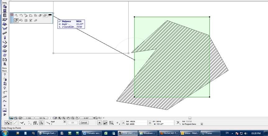

Hi
I am trying to use the pet pallet to subtract the open space around multiple fill shapes from a single large slab that is overlaid on top of all the seperate fills
the intention is so i can be left with the multiple slabs overlaid on top of the multiple fill shapes
The problem is that each time i do this it says
"Region not found around this point!"
Thanks

are you clicking on the edge of the fills? if you hover over the edge of a fill you get the 3-prong Mercedes-Benz-sign-without-a-ring-round-it. when AC is displaying that and you use the subtract function, it *should* work...

When i hover over the edge of the fill i do get the mercedez benz icon but i don't know where to find the "subtract function"
It is pretty obvious that under the normal circumstances when i click on the edge of the fill it will erase the fill area from the slab rather than doing it the other way around which is what i want to do i.e erasing the slab from the areas outside of the fill so that all that is remaining is the slab directly on top of the fill

ok, have the slab selected, hover over an edge to get the 3 prong icon, click once to get the pet pallette open then click the minus button in the pet pallet to activate the 'subtract from polygon' option, then hover over edge of fill to get 3 prong icon, then click on the fill edge whilst HOLDING DOWN your space bar.
Holding down space bar activates the Magic Wand Tool which intelligently tracks the outlines of modelled components...
hope that makes sense. see picture as well - shows pet pallette and hatched fill.
if you can post a pic of the slabs you're trying to create that might help as well!
