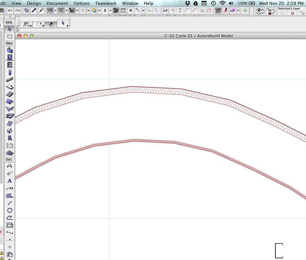

I am working on a curved roof, and used an extruded shell to do it. Quite straight forward, drew the curved shape on plan extruded it with the shell tool, and then just positioned it on top of my building. But when I look at it in section (image attached) it is not a smooth curve as it should be but it appears faceted, composed of straight lines, which is also the way it appears in dwg once I save it for consultants that use AutoCAD, and, of course that is NOT the way it's supposed to be.
Is there any settings I'm missing, resolution of some sort?
Any suggestions highly appreciated, thank you.

Yes, the Shell is made up of segments.
I think the default segmentation setting is 36.
If you don't mind messing with the Registry you can change it.
I see you are on the Mac.
I can show you where to change it in Windows, and hopefully you will be able to figure out how to do it on the Mac.
In the Registry, go to the following place:
Computer\HKEY_CURRENT_USER\Software\GRAPHISOFT\ArchiCAD-64\ArchiCAD-64 17.0.0 INT R1\GSModeler.
Here change the value of ShellMaxSegmentationNumber from 36 to 72.
Also, change the value of ShellMinSegmentationNumber from 36 to 72.
Then Exit the Registry Editor.
Then exit ArchiCAD and restart it.
Go to your Section and regenerate it.
The Shell should now be generated with the newly specified segmentation, giving you a greater resolution.
But note this registry change will affect your machine only.
Anybody else opening the same file on another machine will have the shell revert back to what you originally had unless they make the registry change as well.

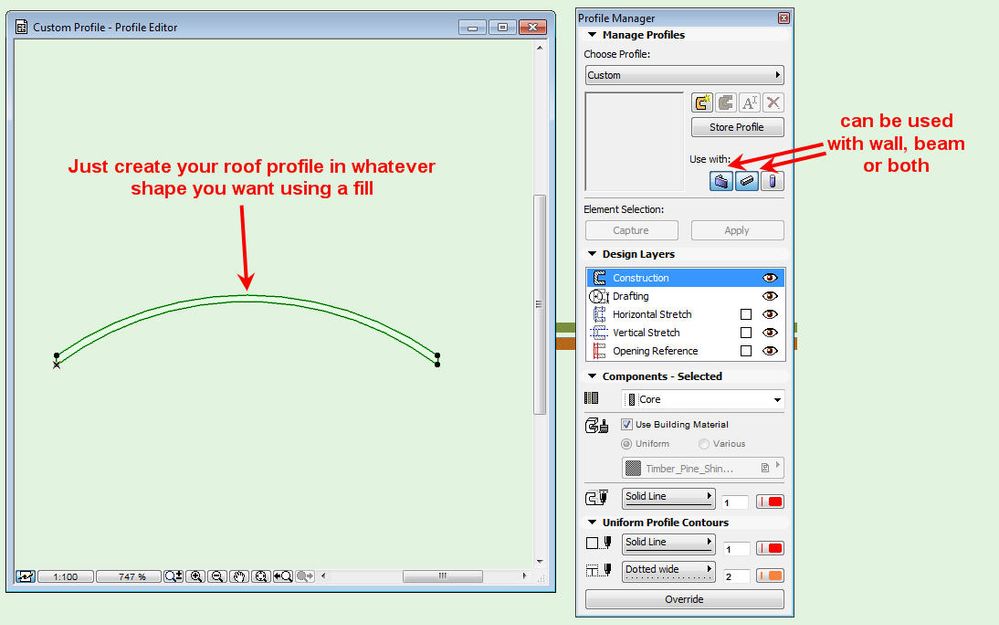

Try using a complex profile wall or beam.
You will have much more control over the curve.
If you use a wall you wall have to be careful about what layer it is in, the layer priority and the strength (building material) of the complex profile because although you are using it as a roof it is really a wall and will interact (trim) with your other vertical walls.
Barry, thank you.
Could you elaborate a bit on ur thoughts on how to accomplish this with complex profile wall? I want to give it a go...
Use you 'Profile Manager' to create a wall and/or beam profile using a fill with the desired shape and material.
Store it as a profile that you can use with the wall and/or beam tool.
undefined
Then use Solid Element Operation to trim the walls below if need be.
undefined
