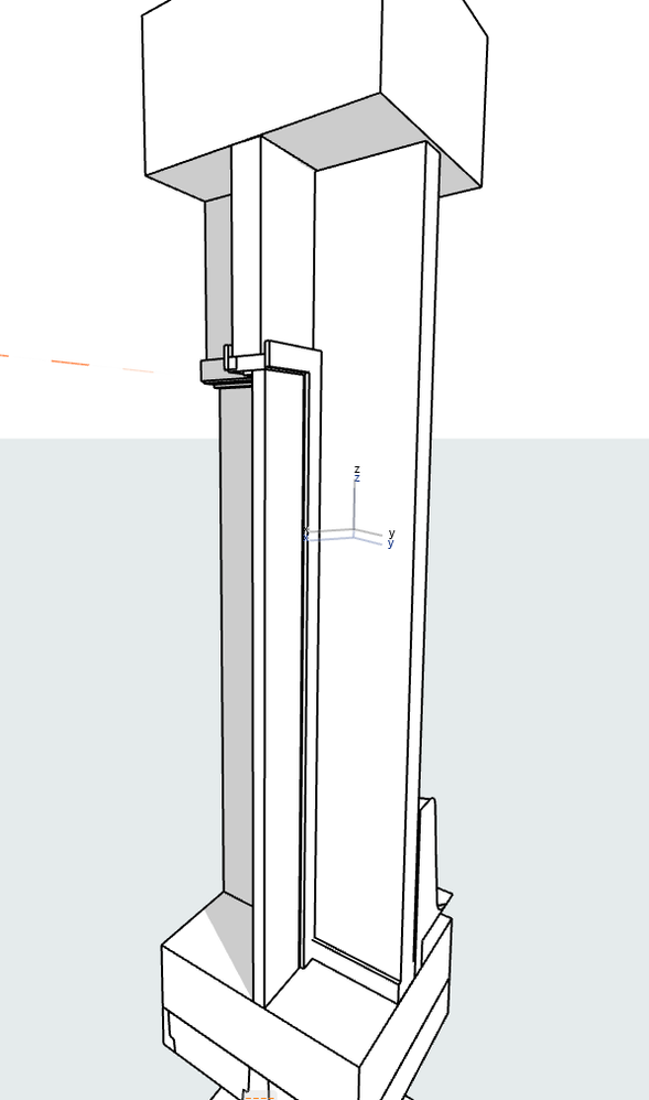

Hi
This is im sure a quick thing to fix but I can work it out. I have a PB wall with skirting modelled as a complex profile. When I insert a door opening it cuts through the wall but leaves the outer most line of the skirting showing either side of the opening. I cant figure out how to get rid of it. I don't want to have to model everything as beams/complex profiles for the skirting sperate from the walls really.
Any suggestions welcome!

Can you place a marquee around one of the door frames and show the 3D view?
I'd like to see if the door goes to the bottom of the wall.
In other words is the base of the door set at the base of the wall?

Please see below. Door is set to the floor along with the associated wall. The frame doesnt seem to touch the wall though, which must be dictated by the skirting in the complex profile.
After thought like @Barry Kelly in the door & wall bottom and I see that's perfect,
I assume you set the door settings - floor plan & section panel - Wall Contour Lines to be Both sides, try to change it to Off in all doors, I hope it works.

Hi Mahmoud. Yes Ive checked that as I thought the same as you. Its inline with the skirting so it seems to be unable to slice through it properly when the door is inserted. I might try moving the skirting up in the CP by 10mm and see if that works

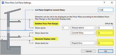

One is to set the wall floor plan display to be 'cut only' instead of 'projected with overhead'.
The other is to play with the Floor Plan Cut Plane settings.
You set the 'relative floor plan range' to be a height just above the skirting height.
This will affect everything in your plan.
Or you can set the 'absolute display limit' to a height just above your skirting height.
Then you set the walls to show
Then for each wall with a skirting you change the 'show projection' setting to 'absolute display limit'.

Looking into it a little more, it seems the cut lines (and fill) of the wall are eliminated.
But the projected lines are not.
So another option would be to lower the Floor Plan Cut Plane to just below the top of the skirting height.
You will however then see a fill for the skirting, but you can set the building material so it has an empty fill.
Then it will be an empty fill in section as well.
