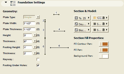

I'm an archicad software user, i have a question for you regarding the Slab Accessory - Under Footing Settings..
I want to find the way to stretch the footing size, i did explode it, but it didn't work please tell me if there is another way to resize the footing...i was ungrouping the Object to stretch out the Object, but i couldnt do it...Please let me know how to re-adjust it.
First ... since this is my second PM in two days from new forum users with theretofore zero posts: I don't get paid to do this. So, please post your question on a forum addressed to the world at large. If you post directly as a PM to me, I'll assume you want to hire me as a consultant (I am a hired gun - I do not work for Graphisoft) and will need to bill you up front. 😉
Rick,
The slab accessories, like all accessories, are applied by selecting the element first (the slab), then the accessory. The accessory will then morph itself to match the slab (or wall, for wall acc'y, etc.).
The Footing object is not hot stretchable. All parameters are set within the object settings dialog (see screenshot). You can adjust stem wall thickness and height, footing thickness and height, plate dimensions, etc.
The names of the parameters are a unfortunate. The screenshot shows the SE library version. What they call 'footing height' is what we call 'footing depth'. What they call 'thickness' is what we call 'footing width'. (Ditto stem wall dimensions.) Slowly, GS is customizing the US library to better user US terminology ... but looks like none of us reported this one.
If you explode any AC element - object or otherwise - it turns into 2D lines and fills. It will no longer be 3D. This has uses at times, but is not what you want here.
You cannot ungroup an AC object into subcomponents either. An object is an element. You can only alter its appearance via parameters (or solid element operations when necessity calls).
Hope that helps ... post any more questions to this thread. 😉
