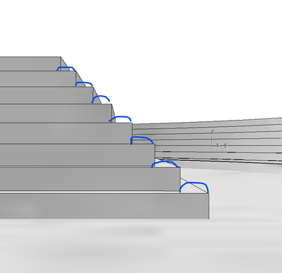

Hello, Can I create this kind of curved shapes with Slab tool?
2 REPLIES 2
No, slabs are flat.
You would have to run a complex profile beam along the top.
Erwin Edel
Rockstar
If it needs to be one element you can also use SEO to add the profile beam to the slab and put the beam on a hidden layer afterwards. It will only show the shape in elevation / section / 3D though, in the floorplan it will be hidden.
