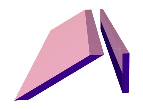

Dwight
Okay. So i am an idiot.
What i meant was that if you put a tilted wall over a conventional wall such that their nodes touch, the tilt wall cuts the conventional wall.
Dwight Atkinson
