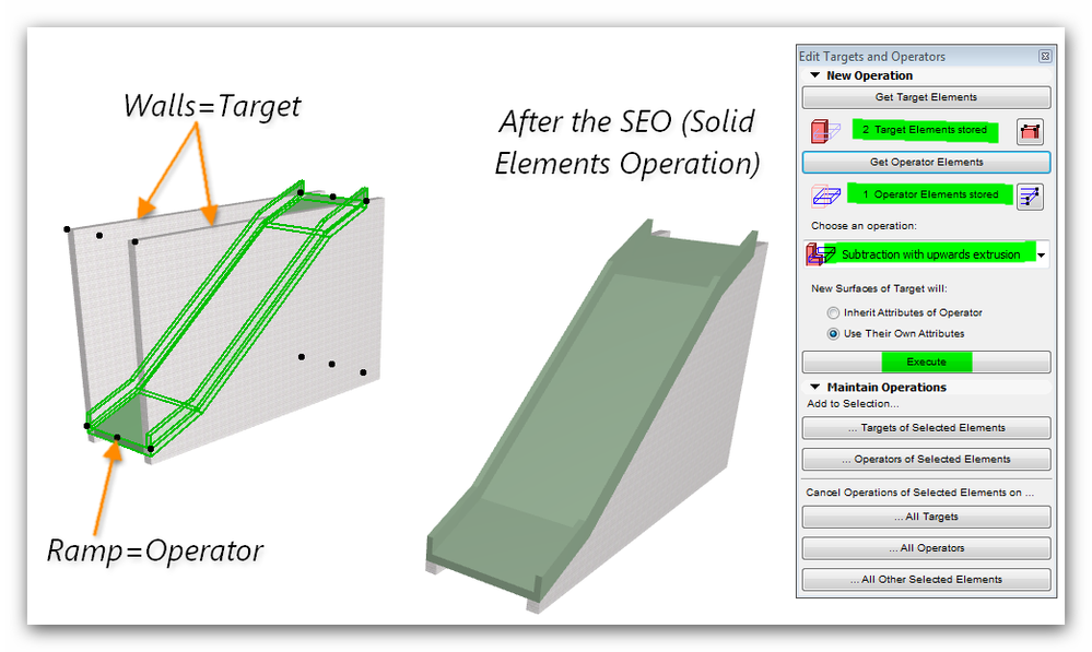

Walls can not be SLOPED!.Anyway, here's an example how to resolve this:

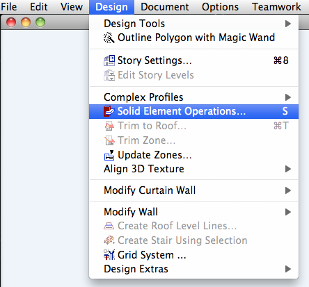

Andro how do i bring up that 'edit targets and operators' box
Thnx for your response Rod.

hrv00 wrote:Again I feel you should spend some time looking in the Ref Guide.
/....... how do i bring up that 'edit targets and operators' box
Or just exploring the menus
Quite easy actually, but in the mean time ............

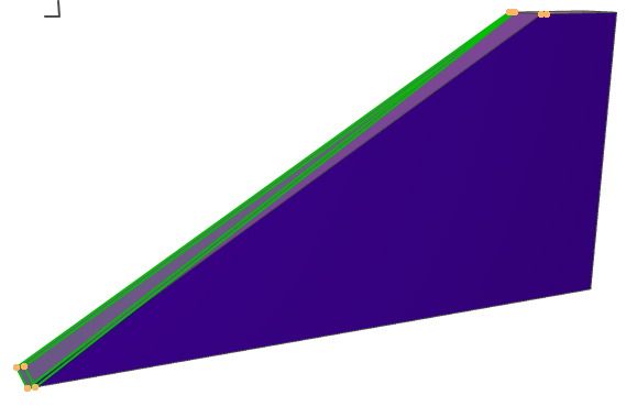

andro55 wrote:Not in the way you might imagine. It is easy enough to make a simple ramp using the tilted wall feature.

Okay. So i am an idiot.
What i meant was that if you put a tilted wall over a conventional wall such that their nodes touch, the tilt wall cuts the conventional wall.

"Andro how do i bring up that 'edit targets and operators' box"[/quote wrote:
1. Menu Design>Solid Elements Operation or
2. activate the toolbar with Menu Window>Toolbars>Edit Elements (first icon on the right side)
