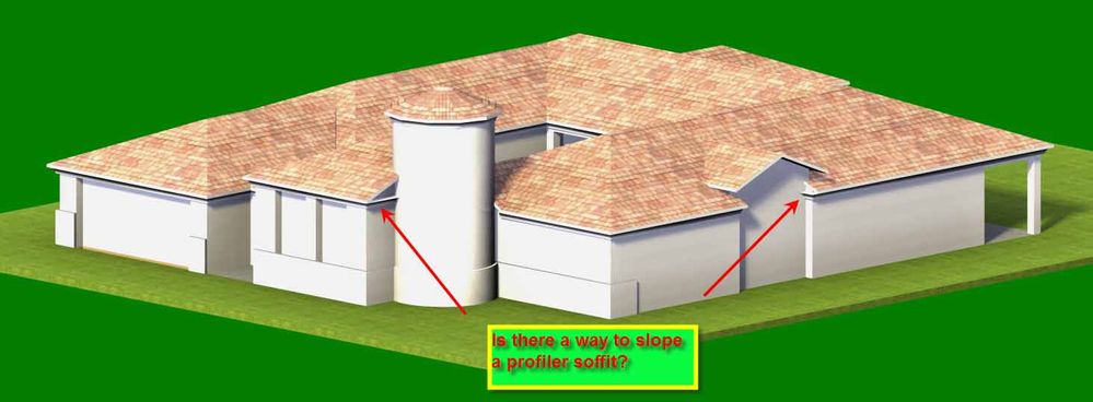

Sloping Profiler
I seem to have forgotten how to make a sloping profile. Can someone please advise me before I kill myself.

I've followed your instructions and have gotten the detail looking decent except for one thing. Please see the attached images. The sloping profile cuts well but when I use a slab to cut the eave profile it doesn't get the correct angle. I believe it not only needs to be cut at a 45 but the edge of the slab also needs to have an angle to get it to clean up correctly? Is this what you did in your instructions? Thanks and sorry, this is my first try at attempting to fully detail a building and there have been a few kinks on my part.

Hello Steven,
The cuts must be plumb cuts so the slab edges
must be perpendicular ie vertical.
Peter Devlin
They are plumb cuts.
I'm thinking it's close enough and will have to do. Notice the problem with the returns not cleaning up too. The return soffit depth is less than the eave soffit depth, so the soffit does not cut at a 45, which means the moldings that are a part of the soffit/return piece also do not cut at a 45. I'm thinking I would have to make each trim piece a separate part on separate layers with different layer priorities for this to work, and I have bigger fish to fry.
Hello Steven,
The cut on the right member appears to be correct.
The cut on the left is not correct. Could you show us
a top down view of these two pieces ?
Thanks,
Peter Devlin
Here it is. Thanks.
Hello Steven,
Why is the left member wider then the right member.
The plan width should be the same. Also, your image
seems to be a perspective. Could we have an orthogonal top view ?
Thanks,
Peter Devlin
They are the same width.
