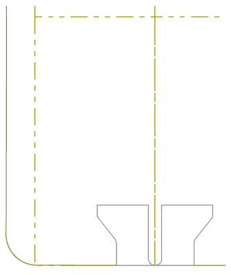

on another thought, i have a problem with slabs as lots. as you can see on the attached image, adjacent lots cause the property line 'line type' to be obscured.
any thoughts?
Lindsay
This is always a problem, unless edges are drawn in the same direction from the same starting point. Annoying with roof lines also.
__archiben
LINZ wrote:
any thoughts?
use a fine pen for your slabs and a thicker one for the boundary line?
that archicad is unable to clean up overlapping model view element lines is a huge documentation let down. try placing two roofs next to each other and showing them on the storey below. a simple dash line cannot even line itself up . . .
