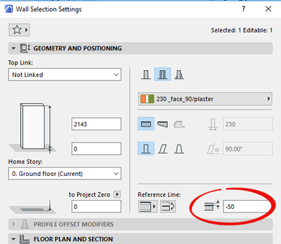

That is a good solution.
It might just be a bit confusing that the ref line is not on the wall.
But it works.
It is also a shame we can't drag the wall or ref line positions without affecting the other.
This means you will have to calculate the offset to get the wall in the exact correct position so you can type the offset in.

There is an Offset input in the Modify Reference Line dialogue that you can use. It appears to work.
Ling.
There is an offset in the wall settings as well.
The problem is in this case that you will have to calculate the offset so you can type it in.
Unfortunately it isn't possible to drag in in plan.
Actually, another problem might be that the offset ref line might interfere with the wall trimming at the other end?

You can measure the offset distance in plan, then use the Modify Reference Line dialogue, as much like changing the reference line position through that dialogue, it does not move the wall.

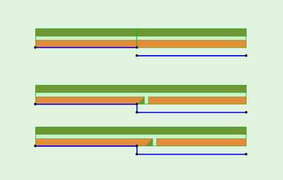

Regarding the opposite end of the wall;

Yeah, sorry, the wall settings (info box) offset will move the wall and leave the ref line where it is.
The modify wall settings does the opposite.
Just splitting the wall should work.
Especially if the ref line is outside the wall - you don't want a little return wall

If you don't do the return wall, in plan there will be a break in your wall.
Just splitting the wall it will all be fine in 3D (elevation) as the surfaces will match and blend with no lines.
In plan there will be a join.
Adding the return might cause problems with trimming.
