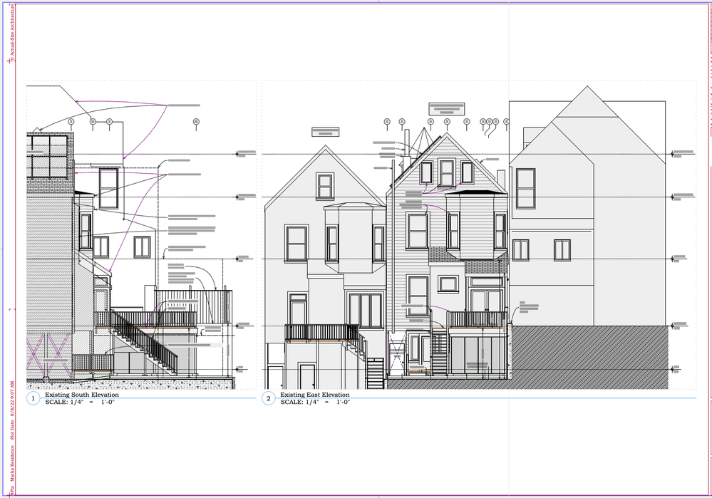

No luck, thanks. But here's another project with the same problem, and I just noticed that in both cases, the stairs don't appear in 3D Docs with Renovation: Proposed, but they do appear in Renovation: Existing. See attached.
Screen Shot 2022-08-08 at 9.07.39 AM.pngScreen Shot 2022-08-08 at 9.07.24 AM.png
AC fan since v 7. Currently on AC 26 Build 5003 USA FULL, and AC 28 Build 3110 USA FULL, Apple Silicon,. 2022 Mac Studio, 32G ram. MacOS Ventura 13.7
Geof Gainer
...actually in this case, it's an elevation, not 3D docs.
Solved! I just selected the ghosted stairs, switched them all to Renovation: New, then switched them back to Existing. They all show up now.
