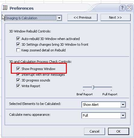

Hello -
This is probably an easy one. How do you stop AC from calculating in the 3D window, section/elevation tool and photorendering window? For example: you start a photorendering and then realize you forgot to adjust the sun angle so you want to stop it mid-way thru and restart after making some adjustments. I used to be able to type "command . (period)" to get it to stop. For some reason it hasn't worked for me for a while. I'm using Mac 10.3.1, AC 8.0v3.
Thanks,
Tom

By default, since ArchiCAD 8, the progress dialog is turned off
Strange really. But to activate it you can find it under your preferences, see image. But CTRL+. hasn't worked for me since ArchiCAD 8.

Ahhh - I think this is what I was looking for. Upon further investigation, I'm finding that command + (.) does seem to work for me in the section/elevation window as well as the 3D window. It results in an "Errors occured during the last opperation" message. Where I was having issues was the rendering window (while using the sketch engine). W/out the progress dialog box there is no way to stop it - at least as far as I can tell - and while it doesn't appear instantly, it does show up eventually and is better than force quitting or waiting 20 min. for the rendering (which you're just going to trash anyway) to finish.
