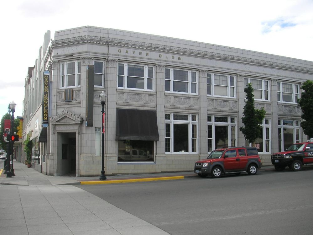

What is it they have put on some of these buildings to make the stone look like marble or at least some better quality or kind of stone? It looks to thick for paint and it seems to have little blue speckels. It's on the Grayer Building.
Dwight
terra cotta
Dwight Atkinson
Steve Jepson
Dwight wrote:
terra cotta
Yes! that's got to be it. Thanks for the link. I will have some fun learning about this.
