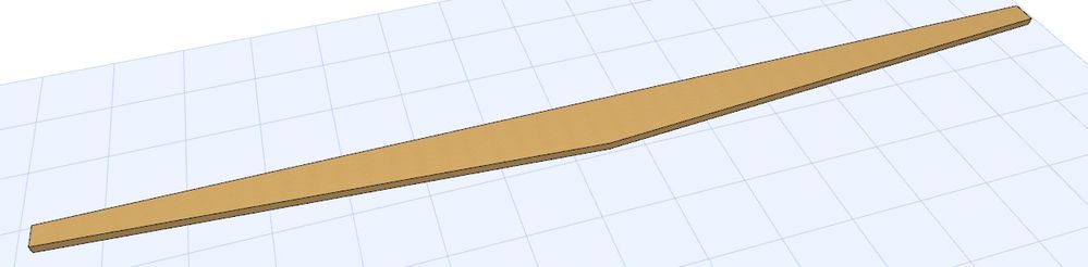

I have to make beams with variable section as you can see in attached image.
How can I do? I tried with objects: inclined beams 15, precast concreate beams but nothing...all that I was able to obtain is a tapered beam but in the other direction!!!!

Three other methods:
1. Use roofs as solid operators to make the tapers.
2. Draw the beams as slabs in plan and save as library parts.
3. Make a beam profile of the joist in elevation so that the axis is placed perpendicular to the span (i.e. a very short, very wide beam).

Thank you Matthew, you are always prepared!!I'll try tomorrow with your methods!!
I'd to know something more about Erika's method, can you explain it?

I'm not sure if this matches what you're after, but OBJECTiVE includes both tapered and cambered beam types (refer to the attached image). The extent of the camber is fully parametric on the top and bottom (in either direction) as is the extent of the taper.

Attached is a screen shot with the slab drawn in floor plan which I saved as a library part and the trussmaker version which didn't produce the desired results

I create my slab in floor plan, but now how can i rotate it?And how can i save it as a library part?

Follow the instructions:
1. Select the slab, open 3D Perspective window
2. In Parallel Projection Settings > Perspective Settings > Select projection Type > SIDE VIEW > Azimuth 90° > OK
3. Now you see the slab from the top as a BEAM
4. Select it and go to File > Libraries and Bobjects > Save 3D Model as... > Save Library Part:
Name.....type a name for the object
Type......Object
Options...Non-editable binary 3D data
Save to..Embedded Library
5. Save
6. Use the tool Object and insert your beam on the plan
