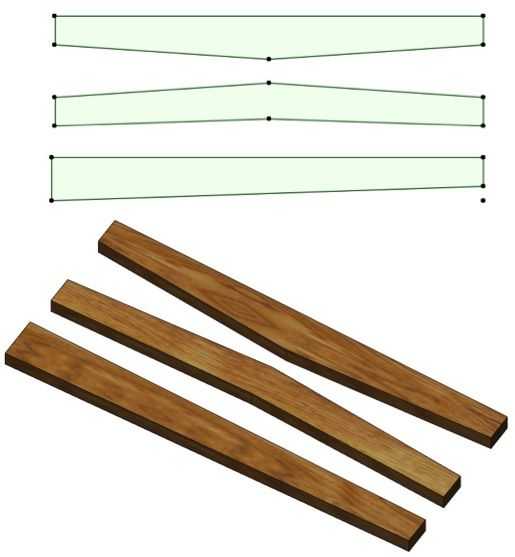

Nicola wrote:I'm not sure if this matches what you're after, but OBJECTiVE includes both tapered and cambered beam types (refer to the attached image). The extent of the camber is fully parametric on the top and bottom (in either direction) as is the extent of the taper.
I have to make beams with variable section as you can see in attached image. How can I do?

2012-04-28 04:10 PM
I suggest looking at Ralph's Objective; It's a great product with easily created and graphically edited objects. Ralph really stands behind his product and provides excellent support.
Attached is a screen shot with the slab drawn in floor plan which I saved as a library part and the trussmaker version which didn't produce the desired results
