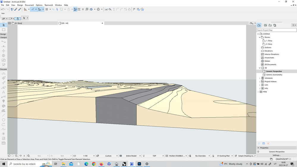

Hello,
what should I do to to flatten then road mesh so that the terrain mesh would follow along road's sides?Ekrano kopija (142).png

Hello @Devonha,
You should use Only one mesh to model variations in topography and slabs to model ground cover variations (grass, gravel, road, path, etc.).
For the slabs to follow the modeling of the unique mesh, it is enough to use the operations of solid elements.
Finally, to answer your question, you must delete the level curves of the mesh that are in the right-of-way of the road and then create new level lines on the outskirts of this road.

@Christophe Fortineau,
To make it clear please confirm or correct the steps below:
1. Draw polylines of the outskirts of the road.
2. Cut splines pf the terrain mesh that intersect in the area of the inside road.
3. Create slab from drawn polylines of the road.
4. Use solid operation tool to combine road slab with terrain mesh.
Also, if steps above are correct, what workflow should be used in solid operations tool to combine existing terrain mesh with road slab?

Hello Devonha,
English is not my birth language so it is not as easy to be sure I am agree with what you write but I think you are right.
