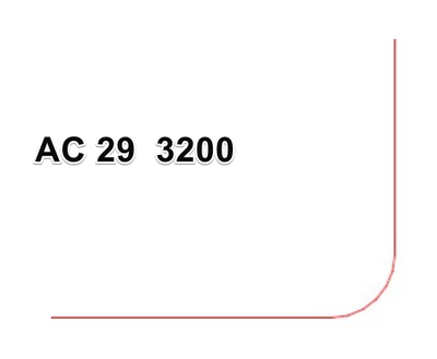

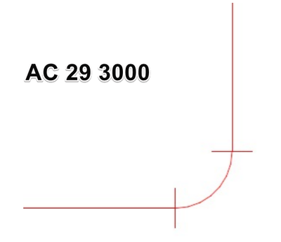

The symbols for elbows in pipes are not displayed correctly.
Hi, I updated the Archicad 29 library, and the elbow and intersection representations stopped working. Is anyone else having this problem?
Operating system used: Windows 3200
Setup info provided by author
1 Reply 1
Could this be caused by an MVO setting?
Can you check the MEP Options panel of the MVO Dialog, if any of the settings there make a difference?
