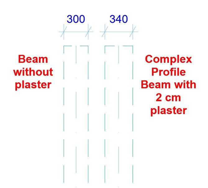

Hello,
I added 2 cm of plaster around the beam I produced with a complex profile. When I draw the beam, the 2 cm plaster thickness around it is included in the thickness of the beam and my 30 cm beam appears as 34 cm.
It is quite misleading because there is no separating layer and it appears as a completely static element.
How can I add plaster around the beam and it won't show up in the thickness of the beam?
Thanks for your help in advance.
4 Replies 4

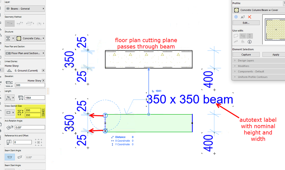

You can create your complex profile with the nominated height and width as just the core of your profile.
Set the plaster as a "finish".
This will allow you to place the beam by the size of the core.
However in plan you will still see the overall width of the beam.
Unless the Floor Plan Cutting Plane happens to pass through the beam, then you can see the skins.
There is no 'Symbolic' floor plan display for a beam like there is for a wall.
There are nodes at the ends of the skins, you can't see them but you can snap to them when you dimension.
Just be aware the dimensions to these points will not be associative (not linked to the beam).
You can also adjust your 'Partial Structure Display' to show just the cores, and your beam will show the core thickness only in plan.
But this will affect other elements as well and you have to do a separate set of dimensions for each Partial Structure Display.
