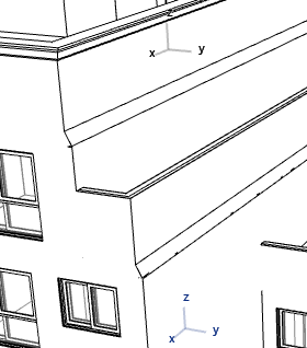

They are all cores and have the same material, but are not bonded.
LeeJaeYoung
1. This phenomenon often occurs in Entire Model when inclined walls are used.
The triangular part shown here appeared. has disappeared....
It was different every time. Strange.
It's the same condition, but I just touched the one below. I only returned it, but what I touched is gone.
2. This is core only mode.
Some have the same upper and lower walls, but they are not joined together.
The problem was when I was working yesterday.
But while I was editing it, all of a sudden it was all combined again.
And the problem of the wall becoming transparent, which I asked if it was an effect of this, was also resolved. (I don't know if this is correct. Coincidence)
Is it normal to look like this?
3. The same material, but not combined, comes out in different colors.
Why is this?

Number 2, 3 is affected by the Uncut Line pen. ^^
this is core only
