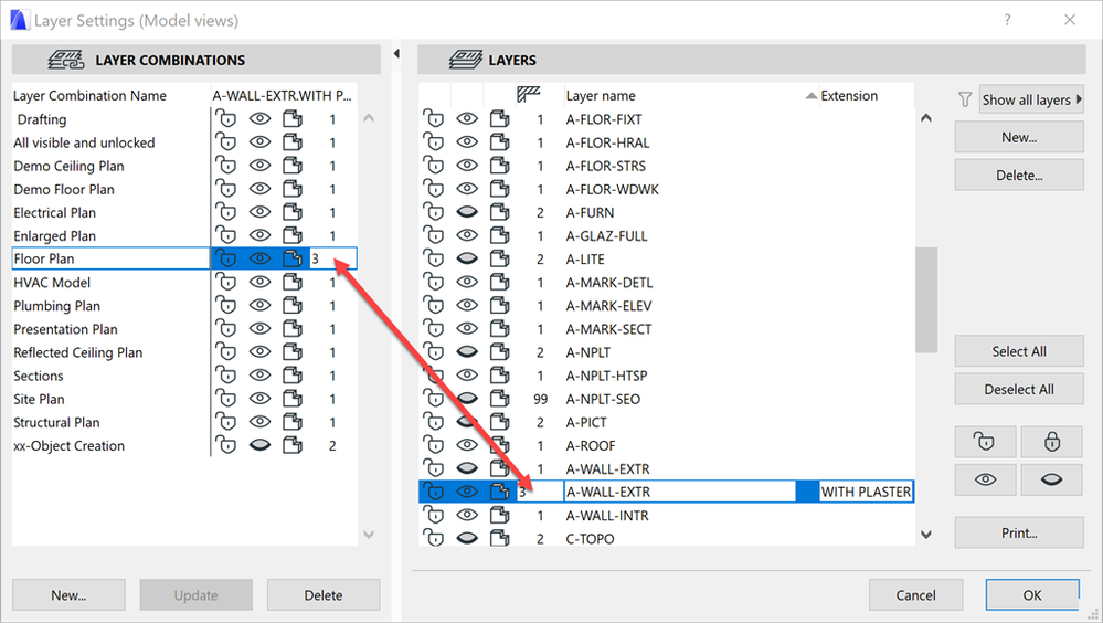

If you need to keep the walls as separate skins for one reasons or another, keep them on different Layers so you can use the different Layer Intersect Numbers to control their intersection. If two elements are both set to intersection group 0 they will not intersect.
The Building Intersect Priority number is for the standard situation you probably want to maintain in other places and for future use. The Layer Intersect Number is something you can use to control element intersections per unique Layer Combinations.
