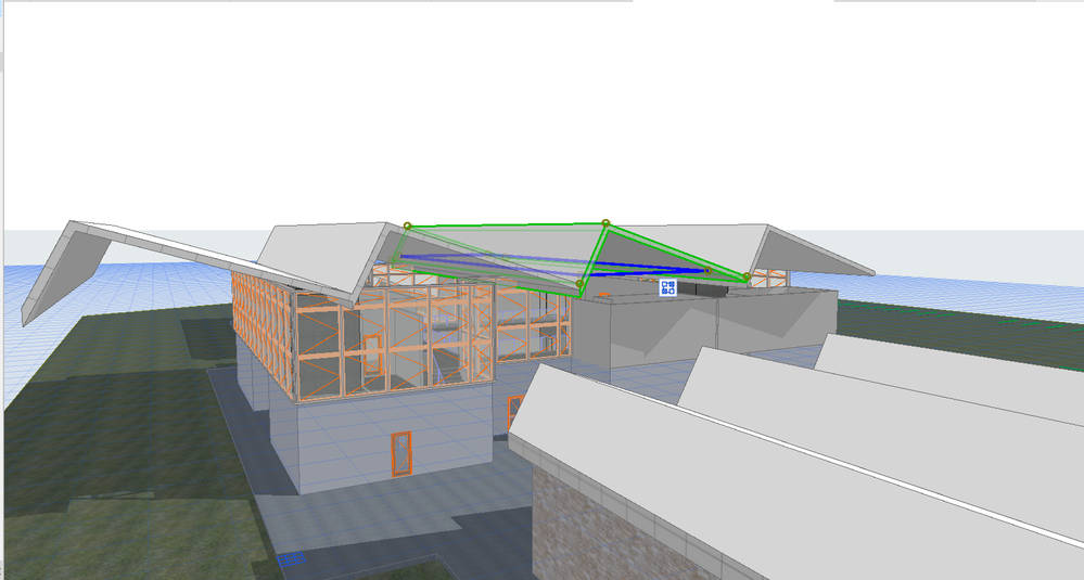

Trying to achieve a sawtooth roof design in archicad 27
How do I accomplish the sawtooth roof design with glazing on one of the sides to achieve natural daylighting? I have attached below my attempt.Screenshot 2026-02-16 114225.png

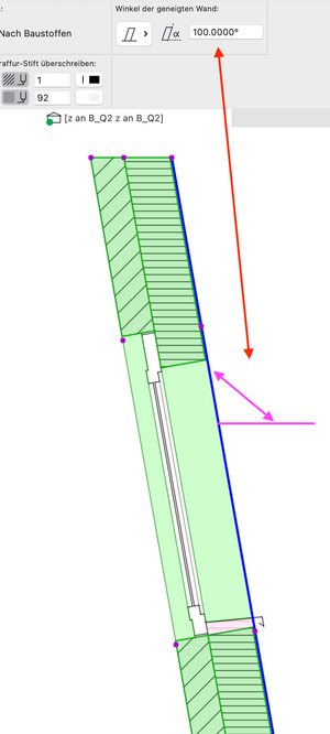

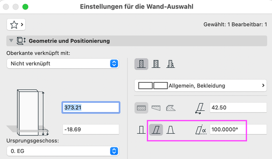

Andreas81ch
Hi Archmjr2026
I had an idea and tested it. It works with wall function with window doors etc;
