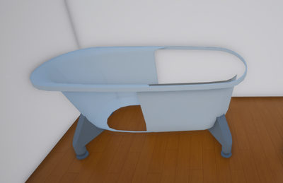

I realized that Twinmotion fails to import accurate Archicad models; even without "Optimize the geometry" selected. Bathtub have holes for example. How can I fix that?

in Twinmotion, select bathtub material and toggle "two sided material"

What are your default settings, screenshot maybe?
Also do not optimize, and no merge. Deselect exclude items smaller than xxx
Are you using fbx import or syncing from Archicad?

I'd like to ask you if you could share a snap-shot of a bathtub in Twinmotion. I'd like to see if your bathtub is complete.

Great! It works. Thanks a lot!
