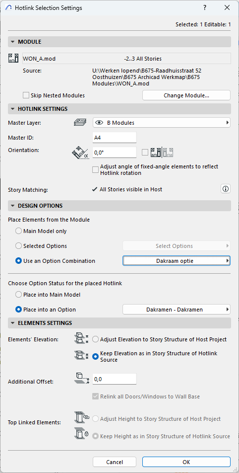

We currently have a project where the real estate developer wants to offer potential buyers an extra option for dormer windows, extensions, etc.
We have made a design option for each individual option in our modules and saved the module with all options visible. When you place the module, you can select which options should be used or use a combination. I think once the sales are final and all options are known, we will make a combination for each unit.
Further explanation: currently the project is not yet on sale, so we have sales drawings that show certain options. For this we have placed multiple instances of the same module showing the possible options. The idea is to later get rid of these and have only the one module showing excactly what is needed.
