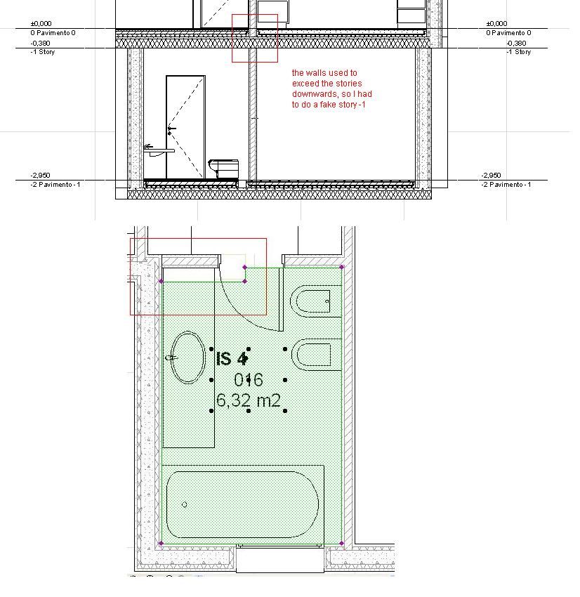

But I'm facing another zone issue... As the image shows, the zone from this downstairs wc is considering a upstairs wall (even if I change the zone height and level). I just found out that zones consider their boundaries between stories, when I tried to solve it making a fake story to the slabs (before that, the walls from the upstairs level were starting a little under the story because I thought the right thing to do was to set the story level to the finished floor level). Am I wrong doing this??? I suppose zones should have vertical boundaries too and "feel" slabs limits for instance...

PatriciaLe_o
aaaahnn! Great! Thanks a lot Link!
Unfortunately I don't think this will help me this time, but for sure I'll use it.
