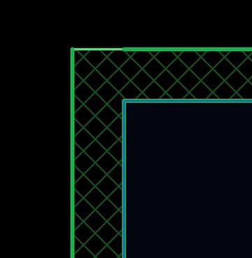

I'm getting this weird wall intersection display that I can't seem to find the fix for.  See attached image; the walls intersect fine, but the wall end line shows a different pen color.  I've checked the composite settings, model view, etc. to no avail.  both walls are on the same layer, & there is nothing on a hidden layer in this location.  Any help would be appreciated.

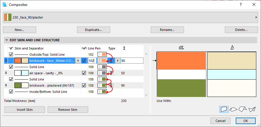

In your composite settings, make sure the wall end line is ON and I set it as the same pen as the adjacent skin line pen.
