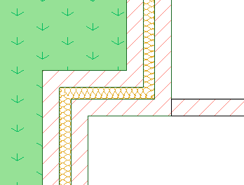

I'm a new user evaluating Archicad. I have some Revit experience to some degree. I see Archicad superior for these wall joints by using priorities, but this is the first problem I encountered. I was about to make a new post, then I saw this thread.
I have a similar problem as Konnos posted. Here are some screenies of a several trials with the intersect tool for the same corner.
And this is the other mode:
The outer wall is a simple composite : plaster+masonry block+heat insulation+plaster
Interior wall is even simpler: plaster+masonry block+plaster
Cant make a good cleanup here.
Check the strengths of your Building Materials.
I would make the masonry block the strongest as you seem to want this to always be continuous.
Then the heat insulation a bit weaker and the plaster even weaker still.
You could differentiate between the internal and external plaster if you want but this shouldn't matter as they are separated by the stronger masonry block.
In this case make the external plaster weaker than the masonry block, the heat insulation weaker and the internal plaster the weakest.
This means of course you need two separate materials for the internal and external plaster.
The second mode is the one you want - Legacy mode turned off.
Otherwise you will not see the effects of the priority strengths in the 3D window.
Hello again,
Thank you Barry. The forum banned me after posting, so I could not read it earlier.
I have to mention that my priorities were ok in this situation .After meddling with these walls, I figured (as previously mentioned here), the key is wall reference lines. All walls' reference lines must intersect. I had to change some parts to inner core face in order to meet interior wall. After then, it all cleaned up.
