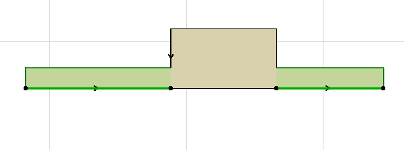

You can also use a polygonal Wall for the thicker portion.
Check the attached image.
I have shown it with Reference Lines visible so you see how the Walls' geometries were created.
Thanks Lazlo, this worked. To be completely honest I am kinda baffled on how (even) simple walls can connect properly. I fail to understand the logic behind the wall tool so I am at a trial & error phase. :S
