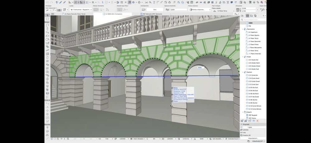

I like to model a cove like this in the wall corner, tried opening tool but couldn't achieve it, I don't know it's a painting finish or special blocks stacked to produce this beauty.
If anyone knows how can this be modelled in Archicad? thanks.

Yes, the corner must be a Morph SEO-d.
This amount of grooves may not affect the performance now, but if you model them on a whole building, you will have thousands of SEOs and you can get to a point where they may.

Hello @Mahmoud Qenawi,
If you're still interested into the argument, there are the Youtube link of the webinar(it's in Italian and divided in three parts), there is also the presentation of the new HBIM library parts, but I think that them will be available only for Italian SSA/forward users.
https://youtu.be/pYxkYHZ91yM?si=WAP2QsiXFFR8d_rA
https://youtu.be/ALOPNv0l3A8?si=-_a3ncEsi5ieVl2-

Sure I’m still interested in these HBIM series, I never knew how CW tool can be a fantastic solution for this kind of historical buildings.
