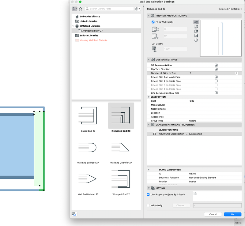

I rarely (never) use the wall end tool, but one of my clients pointed out that the wall end has no parameters for pen settings. I found that going to edit selection set allows me to change the pen of the internal face of the wall end. But this really should be a setting somewhere in the tools dialog.

That particular wall end should automatically get the fills and pen colours from the wall you place it on.
Some of the others you can control them separately.
Patrick M
Ace
yes, thats how it should work, but there are no gray pens in the walls settings, composite, or bMat settings; and yet the pen separating the wall end from the wall is a gray pen. Obviously it's a variable, since the edit selection set kicks it to the correct pen; but it's not an accessible variable from the wall end settings.
Can you show your wall composite settings?
You are turning 2 outer skins but there seems to be 3 outer skins in that wall (all empty fill)?
I am wondering if it has to do with the wall lines between skins or the end lines of those skins.

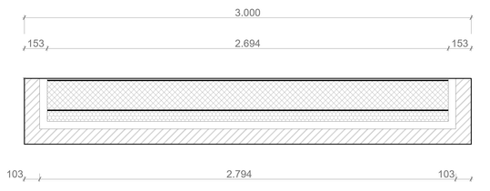

The wall end tool is present in Archicad since version 8.1, if I remember correctly. Up to v.27, this tool has had no significant changes.
The functionality of this tool is very limited, wrapping an outer skin to the wall core thickness only (like it is possible in windows/door reveal types) is not possible.
In an advanced (open) BIM enabled software, which Archicad should be on v.27, this is not acceptable. Exporting to ifc each wall end is not part of the wall, but it's own element which has to have it's own properties. In Archicad, scheduling on an element level subtracts the wall-end surface, but the wall end surface on it's own doesn't give any value at all. The same problem is present with scheduling on the components level.
The window reveal is part of the wall, as it should be.
In the given schedule example the wall is 3m long and 3m high with no openings.
If you are working on a BIM enabled project, or want to schedule quantities, don't use the wall end tool. But, in Archicad, we do have all the MEP and Structural Analytical tools.
