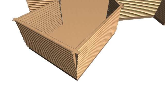

Good afternoon! I have been using a log wall I created as a complex profile and set as a favorite. It has worked just fine up until recently when I noticed an issue with the way it joins together at an outside corner for example. Hopefully you can see what I mean in the attached JPEG file. In the past it has always formed a nice 45 degree mitered corner and then I can add corners as needed. Any thoughts on what setting I may have changed by mistake?

Did you check the group intersect number in your layer settings?

Your log walls might be trying to clean up with your fascia for something with the same group intersect number but not visible in that view ?

The only items I have drawn in this project are the first floor slab and the exterior walls.......They are on different layers (floor vs. wall) so I am not sure what intersect points could be interfering. Something changed because even when I open previous designs that were once correct I am seeing this issue. I don't know if it's something I cause or not but I'd love to know how to fix it

I tried changing the A-Wall Exterior layer to 2 while the A-Floor layer of my slab is set to 1 but that didn't correct my issue. I do add exterior corners later in the project but I would put them on another layer with a different intersect number from the wall layer so they don't join.

Can't seem to get it to make the error. Did you try to create/duplicate the Profile again? it might be something there.

My log walls are a profile that I created to match our logs which I haven't changed or created newly. Even older projects with log walls are doing this. I am not great with this software but will try to create a new log wall profile and see if that corrects the issue. Thanks!
