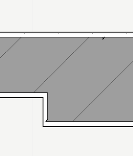

Hi everyone,
I'm getting an unwanted separation line in my composite wall, the wall has different thickness in different places so i cannot find a way to keep the reference line align.
The line appears exactly where the wall thickness changes, Is there a setting I'm missing?
Thanks in advance

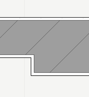

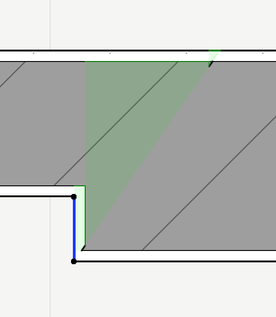

Walls only get "connected" if their reference lines touch.
Try to play with the possibility to move one of the ref lines.
However, you will find that even while now the walls are connected, the outer skins are not.
runxel_2-1759180396038.png   runxel_3-1759180408716.png   Bildschirmfoto 2025-09-29 um 23.15.00.png
You can try to put in another small orthogonal segment in between.
It needs to be made from the thicker wall (right pic) for it to clear (mostly) without any visible glitches in 2D.
Last possible solution is to do the classic Murray and clean up with a column.
