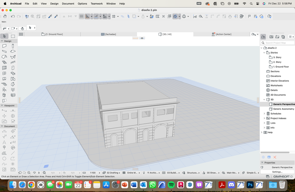

I'm trying to change the surface of my walls, but they remain white. I'm using a composite wall and I have clicked on override surfaces.   

Your whole model is white.
Have you activated the "White model" from the 3d settings somehow?
Or you have a Graphic Override Option enabled?

Hi! I'm not sure what you mean, I apologize since I'm still new to the program. I received this file from someone else who was working on it, and I'm trying to change the color of all the elements in it: columns, beams, walls, and slabs.

Hi! I'm not sure since I received the file from someone else who was working on it and they have no idea either what that is. We are still new to Archicad. Where can I find the Graphic Override Option?

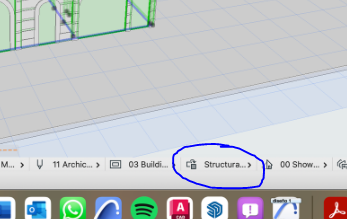

Hi! I tried selecting only one wall, but I still couldn't get it to change. But I figured out what was wrong? I went to Overrides and selected No Overrides, and I was able to change the surfaces! Thank you all!

you have override on, select this and choose no overrides.
