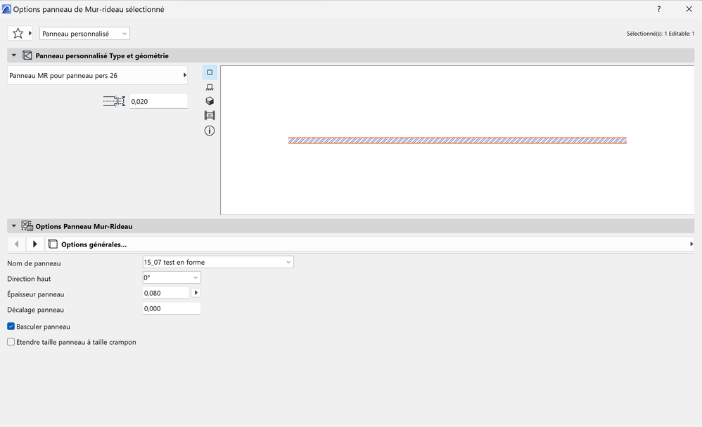

I created a new panel type, which is located in the embedded library (called : "fenêtre coulissante v2"). But when I try to choose it, when creating a curtain wall, archicad only proposes the basic list of panel type. I cannot add any type.
Any idea of how I could resolve that issue ?

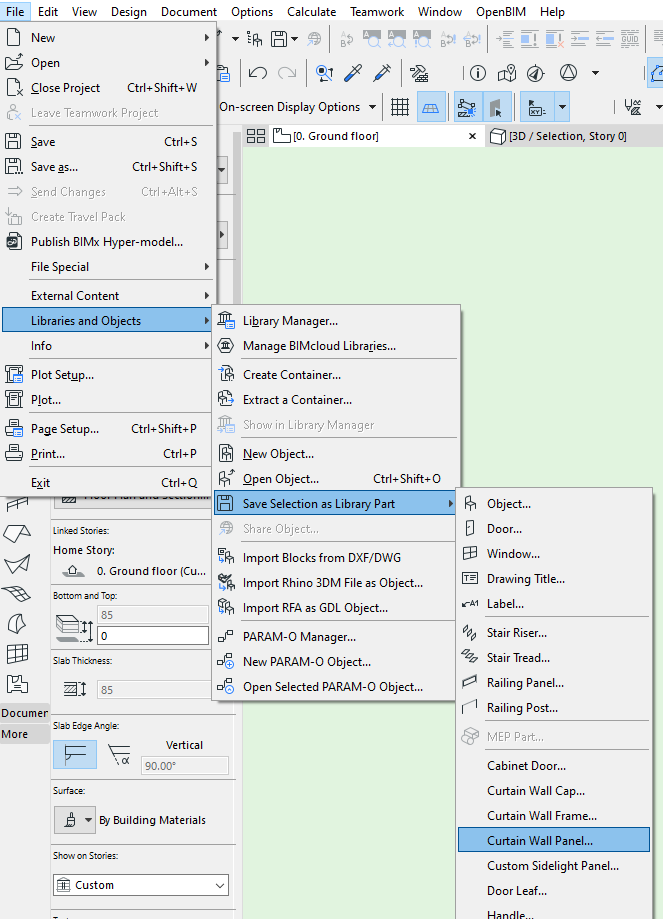

When saving, make sure you save it as a 'Curtain Wall Panel' - which I assume you did do.
Then in the curtain wall settings, there should be a "CW Custom Panel" - I believe in French? it should be "Panneau personnalisé MR"
If you are not seeing the "Custom Panel" option, then that usually means there is something missing from your loaded libraries, or maybe you have duplicate libraries loaded?

Thank you very much for your answer. I found the custom panel, but the result is quite strange. It does not look like a window at all. I just saved the basic sliding window (converted- or not, i tried both- nto a form) as a CW panel, but when i want to use it it looks like a big wooden wall...

Basic sliding window? Are you sure you did not just save the wall? Depending on the default window vs. curtain wall panel paramters, you might be able to open the window object and change it's subtype. This would give you more functionality, though if the default parameters are different, doing this would be a bit complicated...
