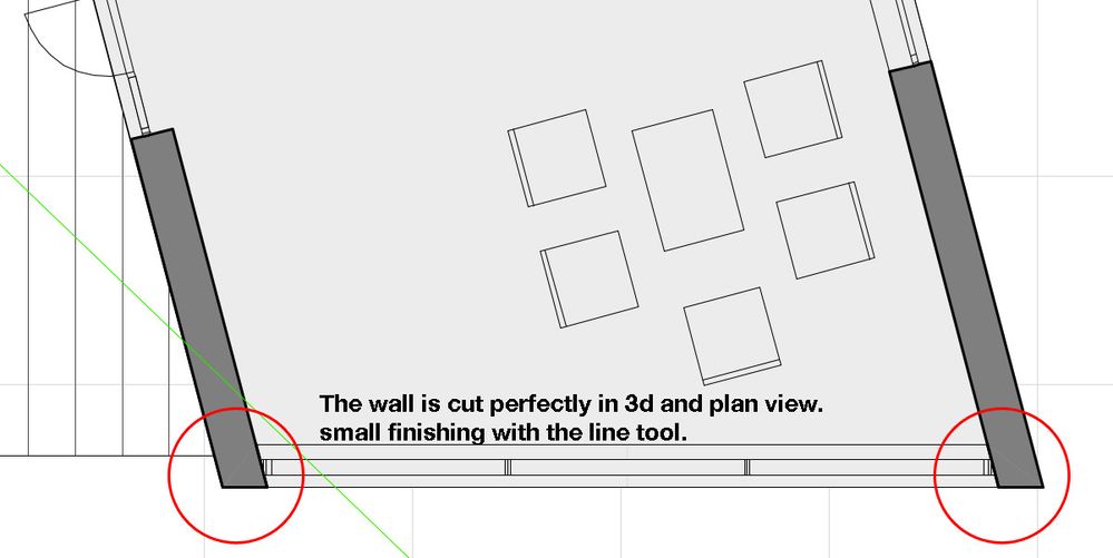

What about using the rectangular hole window object in the library?
See my attached image; it seems that the object doesn't allow negative reveal angles, so i've used two next to each other with one reveal angled and the other perpendicular and then flipped and mirrored one to reverse the direction of the angle.
you could then place a new wall withing the opening to house the window object, as previously suggested, or just place the window into the existing wall, overlapping the wall hole object.

Sounds like a better idea as it does create the desired look in 2D.
I was not aware of this Library part option.
