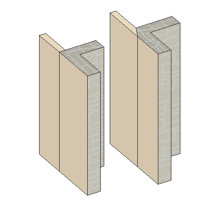

For many cases it doesn't matter, but the joint pictured here will only clean up if the ref lines are inside. This was probably the determinant for us. It's been a while. Of course, both methods fail in 3D; you get a line where the stud wall meets the corner. I dream of the day that wall cleanup just works.
This is what Matthew was referring to right? This is where I find gyp and ply skins are better left out of composites, as they create as many problems as they solve, if not more. Conversely, the same problem would arise with external walls if your reference line is on the outside.
In 3D it becomes moot. I really, strongly, dislike that line.
Me too James - especially since the materials are the same.
