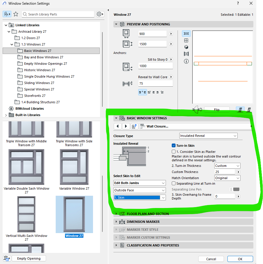

I have two questions about the return on a window reveal in a composite wall.  (I'm attaching a screenshot below.)
1.  Can I have two composite skins return into the window reveal?  I'd like my stucco (green) AND my waterproof membrane (cyan) to wrap into the opening.   (I have a workaround for how I'd actually construct this, but it will be a pain to model!)
2.  I've got the composite skin ends turned on so that everything joins up properly, but that means it gives me a little "tail" where the stucco returns into the window reveal.  Any way to turn off that little green nub??
Hopefully you folks have an easy answer!!

Have you tried fiddling around with the settings for the wall closure ->
If I understood your question correctly, you can achieve your desired turn-in by adjusting those parameters.

CosminF
jd10003
Ok yes thank you.  I didn't realize it was a two-step process....select the skin from that drop down and then adjust its parameters separately.  Got it.  Thank you!
