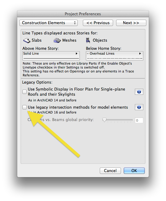

You should read the migration guide (under Help) for 16 to 17. The problem with a 16 file might be that you have "Legacy Intersection" selected.

No, I unchecked that thing.. and the same issue appears in a brand new AC17 file with AC17 library... kind of weird that nobody else seems to have this issue
