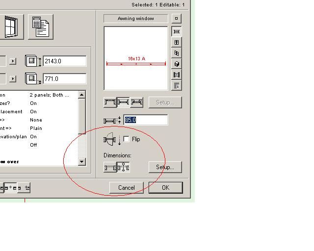

I have recently upgraded from AC 7 to AC 11 (so as you can imagine I've missed out on quite a lot of new features.) I'm loving AC 11 in comparison, but I call AC 7 'ol reliable because it wasn't overly complicated and mine ran virtually bug free.
I've worked through most of the new features in AC 11 but I am stuck with one annoying little thing. In AC7 you could turn off the window dimension text quite simply (see attached image)
Where do I do the same function in AC11 ?

Look in your Info box.
Expand it to see all. And check your WE to see it is checked to be seen.

Thankyou Rod ... very helpful

It is better to use this:
Document/Set Model View/Model View Options...
In this way you do not have to select all the windows and doors to remove the dim. marker.

Great tip kliment ... thanks !
