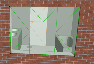

Hello, I am working on a large project which I was almost finalising, however all my windows became transparent. I have tried everything but it is still not working.
Please see below for reference:
Could anyone please help me fix it?
Thank you.

Did you make changes to Model View Options?
Lingwisyer
Guru
https://help.graphisoft.com/AC/28/INT/_AC28_Help/050_ViewsVB/050_ViewsVB-110.htm
Maybe you turned on Transparency in the 3D Styles Dialog.
Your saved 3D Views store this setting, so maybe you activate a View and it has this option on in it.
