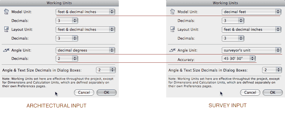

It is different in the world of imperial measures. For me the typical setting is feet and fractional inches with decimal degrees (at highest accuracy), but when I'm working on a site/terrain model I typically need decimal feet and surveyor's units, and for furniture and casework I will sometimes work in fractional inches.
Of course the one time I was working entirely in metric the office standard was millimeters avoiding the decimal point comma confusion altogether. We just got used to quickly typing three zeros for whole meters - it actually works quite well.
So I guess that means: Not a Model View Option nor part of the Work Environment, but easily changed per the user's preference. Make's it kind of an odd duck I suppose.

I have attached an illustration of the changes needed to switch between Architectural Input and Surveyor's Input when using Imperial Units in the US.
I think the ability to give these settings a named set, then easily switch between these sets would work well. As the units show in the Coordinates Palette and Tracker, a small arrow (similar to the small arrow that allows changes to the Reference Level in the Coordinates Palette and Tracker) in the Coordinates Palette and Tracker would be the logical place, as these units affect the input, not the output seen in Views (Dimensions, etc).
