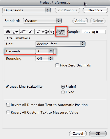

This is the field in Project Preferences (in Working Units as Erika said) that controls it.
See attached image.

Fabio:
I think the setting you are looking for is under Project Preferences > Dimensions > Zone units.
David
