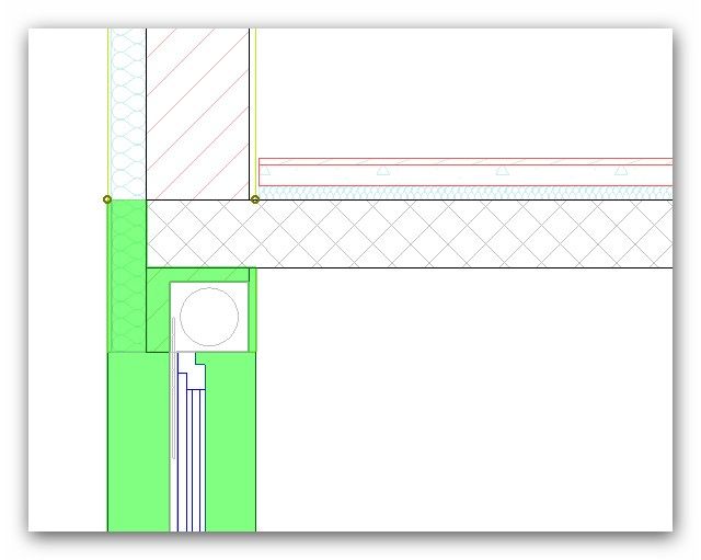

I model walls and slabs in this way:
1. Top height of the external walls is top plate of the bearing slab
2. External edge of the bearing slab meets the insulation skin of the wall
3. Then I use SEO....walls as target, slab as operator; Subtraction.
4. Finish floors are Composite Slabs on their own Layer. Their external edge is on internal skin of the External walls.
http://www.archicadwiki.com/ModelingRelatedWallsAndSlabs

Whatever method you choose, remember display order works in section views. Bringing the slab's display order forward, covers the excess wall nicely. SEO works, but I find display order more flexible in this case.
A 4th method not mentioned in the Wiki is to extend single story walls down to the top of wall of the story below. If so, change the walls' floor plan display to home story only.
HTH, Snap
