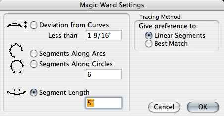

I am not sure where to start the roof drawing.
Do i start with the peak of the roof or the lowest point?
From there do i then go to the same process as the simple roof tool?
Which way does the curve go when you draw the curve for example to the right?
I need the roof to appear like a large bell over the top of a custom cuppala. Does this help?

For Orthodox churches and other elaborate tower caps, you should not use the roof tool. Rotate a profile to create a suitable form.

Make a fill using the magic wand set to a reasonable, uniform interval.

The setting for magic wanding the fill
