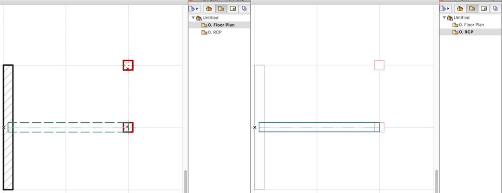

Can anyone tell me how to show my beams on my ceiling as a solid line rather than a dotted line.
We want dotted line for floor plan and solid line for ceiling plan.

Eduardo Rolon
AC 20 graphical overrides do the trick.

I am not sure I read this revived, nine-year-old thread correctly, but if the issue at hand is "how to draw the same overhead beam with Solid line on RCP plan and Dashed line on regular plan?", then you can do that without having any GDL knowledge or waiting for a future ARCHICAD 20 release.
Beams are usually located above the Floor Plan Cut Plane and, thus, are shown on a floor plan with dashed line by default.
If you move Floor Plan Cut Plane above the beam's elevation (even beyond your upper floor level) all beam outlines will turn solid.
Floor Plan Cut Plane position will be saved with your View, so you can make different Views for regular plan and RCP.
You can work on agreeable pen colors and weights by saving specific pen set for your RCP-related View in a View Map (separate from your regular floor plans).
You can also use Model View Options to fine tune how beams look in plan (with or without centerline). This setting is also savable with View settings.
Floor Plan Cut Plane settings dialog became first available in 2006 in AC10, so the original poster could have used this technique in 2007.
Am I missing something?

Actually, I don't think they would in this case, or should in general.
Correct me in I am wrong, but it appears that your sceenshot shows an override rule that you can't save with a specific View within a View Map (beam overridden with this rule will always be zigzagged regardless of View settings) defeating the point by the original poster of having the same element (beam) to be shown differently (solid or dashed) on different views (floor plan and RCP).
If the issue is to simply change beam outline to Solid Line instead of Dashed/Hidden on every view within a View Map, I don't think you need to wait for AC20 ether.
You can simply make sure that Floor Plan Display of the beam in question is set to "Projected with Overhead" and select "Solid Line" under "Outlines/Overhead Lines". Works in all versions of ARCHICAD.

Couldn't see if anyone has mentioned 3d documents as an alternative way to produce RCPs. Since i discovered this method, I haven't done a RCP the conventional way again...
Basically, from plan window, create new 3d document, then select created 3d view, open settings dialog and change projection selection from plan to ceiling.
Benefits:
-Accurate RCP of of 3d model view; no need to worry about line types;
- Can turn on vectorial hatching if required;
- Can adjust cutplane to show or hide furniture as required (i.e. hide items below cut plane);
- Easy way to check modelling of ceiling/soffits etc.

I think what you proposed works only in simple situations ... so simple that maybe never happens ... I mean when you place the FPCP above the beams' level, yes you get the beams with a solid line, but you also cut something belonging to the upper levels and not the walls you see in the normal floor plan ... So it's not a RCP.
AC20, on the other hand, helps to do achieve a better result.

GO's can be saved on a per view basis so I can have one View with Zig-Zags, another copy with a GO for solid etc.
